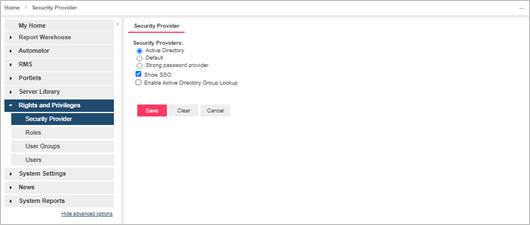

3.     Click on Rights and Privileges, and then choose Security Provider.

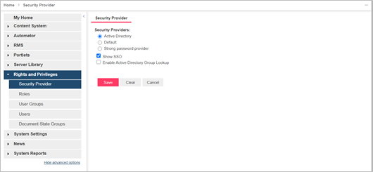

4.     Under Security Providers, select Active Directory, and then select Show SSO.

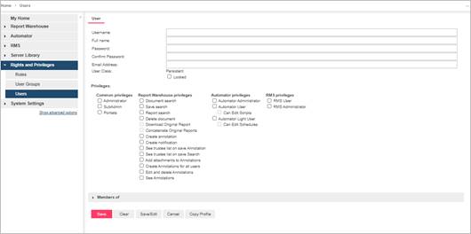

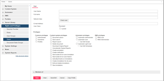

q  To add an administrator user account, choose Users under Rights and Privileges in the Navigation Tree. In the Users window, click on “+” to add a new user.
In the User window, provide the necessary details. To check if the user account you are creating already exists, click on Check User. Do not forget to click Save.

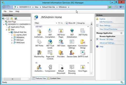

6.     Make sure that Windows, ASP.NET Impersonation authentication on IIS for the Administrator and Client applications is disabled.
1.     Go to Start > All apps > Windows Administrative Tools > Internet Information Services (IIS) Manager.
d.     Go to MSAdmin > Authentication, and disable ASP.NET Impersonation status.
Go to MSClient > Authentication, and disable ASP.NET Impersonation status.

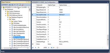

If you fail to define at least one administrator user and cannot login to the Administrator page, edit the Configuration table, and set the OptionValue of SecurityProvider to DEFAULT. The steps are as follows:
a.     Open Microsoft SQL Server Management Studio.

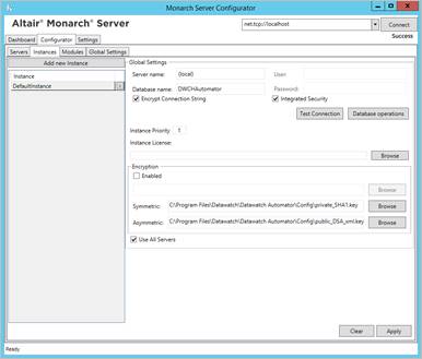

b.     In the Object Explorer panel, click Databases, and choose the database you are using. (You may check the database name using the Monarch Server Configurator. Under Configurator, click the Instances tab. The Database Name is shown in the Global Settings window. Refer to the image below.)
c.     Under Tables, right-click on dbo.configuration, and then choose Edit Top 200 Rows.
d.     Look for the OptionId “SecurityProvider,” and then change its OptionValue to DEFAULT (case sensitive).
