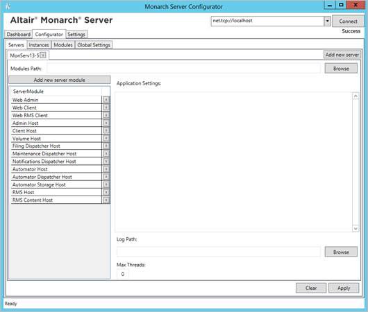

To configure the list of services that should run on the server:
1. Select the Configurator tab, and click the Servers tab. The Servers page is displayed.
2. Click the Add New Server button to add new services.
3. In the Modules Path field, specify the path for modules.
4. In the Add New Server window, specify the server module you want to add.
5. In the Application Settings field, specify the application settings for the required host.
Host application settings should observe the following format:

6. In the Log Path field, specify the log path.
NOTE |
q The path specified is resolved in the context of the server that the setting relates to. Therefore, in clicking the Browse button when adding a log path to a new server, the path is assumed to be resolvable to the specified server. This case should be manually verified. q Some actions (such as test connection when using Windows authentication) are carried out in the context of current users and NOT in the context of the service account. |
7. In the Max Threads field, define the maximum number of threads.
NOTE |
q The Max Threads setting is useful for the following hosts, which are able to run some jobs or tasks: · Maintenance Dispatcher Host · Filing Dispatcher Host · Automator Host · Automator Dispatcher Host · Notifications Dispatcher Host q This option stands for the number of tasks/processes that are fulfilled at a time for the corresponding module. q The Max Threads setting is used in the SmartThreadPool, which accepts a maximum of 25 threads (the same for 0 Max Threads or empty). Increasing the Max Threads setting for some hosts could affect the performance of other hosts. Moreover, large Max Threads could affect the performance of the host itself because of the context switching between all thread pools. Thus, the optimal value lies in the middle and depends on the environment, number of processor cores, and network. |
8. In the SDK Settings section, specify the export storage settings:
· Select Local DB database type, if you want to use SQL Local DB as an export storage and specify Database File Path (if Database File Path is not specified, database files will be created in the user’s directory %LOCALAPPDATA%\Datawatch\DatawatchEngine).
· Select Remote DB database type, if you want to use SQL Server as an export storage and specify its parameters:
¨ Server Name
¨ Authentication credentials: user name and password. If you want to use Windows authentication, select the corresponding check box.
9. To enable SDK trace logging, set Trace Log Folder and Trace Log Level (0 – none, 1 – min, 2 – max).
10. Click Apply to save changes.
11. To delete a service, click the
button by the service name.
12. To add a new server, click the Add new Server button.
13. To delete a server, click the
button by the server name.
