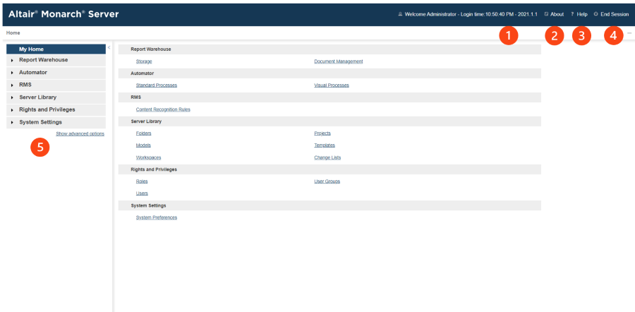

Main Page of MSAdmin
Upon logging in successfully, the main page of MSAdmin is displayed.
Panels and Functions
1
Login Details
This shows the last login time and the current version of the application.
2
About
Clicking this button opens the About window that shows details such as product version, assembly version, SDK version, and DataPrep version. Company information and a link to the list of open-source software used are also shown here.
NOTE: For Monarch Server 2021.1.1, the SDK and DataPrep versions are as follows:
SDK version: 17.1.1.31052
DataPrep version: 17.1.1.31052
3
Help
Clicking this button opens a related page in the Administrator's Guide.
4
End Session
Clicking this button logs you out of the application.
5
Navigation Tree
This panel serves as the navigation point for Monarch Server. Click Show advanced options to see all available sections in the system.
