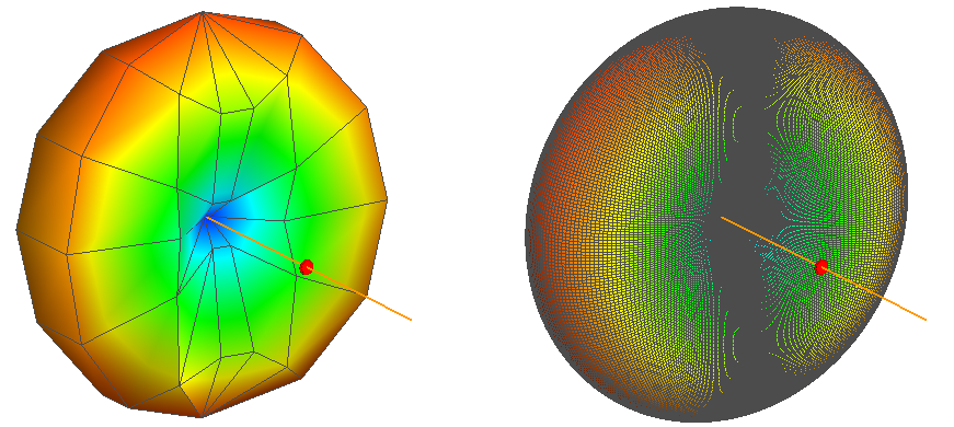

Far Field Interpolation
- Calculate continuous far field data
- This option uses interpolation to display far field data in POSTFEKO.
Figure 1. The result of a 3D pattern far field request with and = 13 points (on the left) and the result of a 3D pattern far field request with = 7 and = 13 points with the Calculate continuous far field data option selected (to the right).
